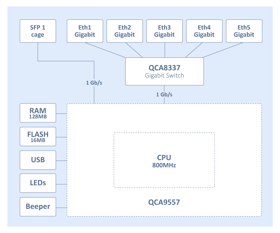

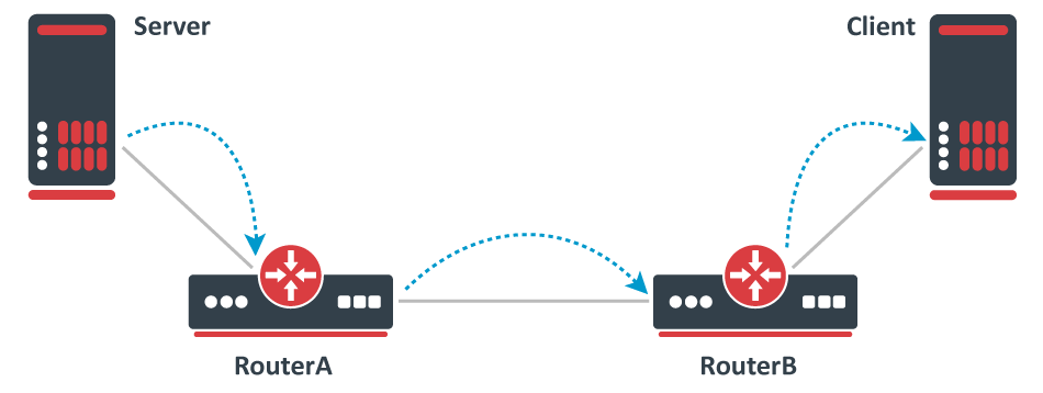

When running Sniffer or Torch tools to capture packets, you might notice that barely any packets are visible, only some unicast packets, but mostly broadcast/multicast packets are captured, while the interfaces report that much larger traffic is flowing through certain interfaces than the traffic that was captured. If you add two or more Ethernet interfaces to a bridge and enable Hardware Offloading, then the switch chip will be used to forward packets between ports. To understand why only some packets are captured, we must first examine how the switch chip is interconnected with the CPU. In this example, we can use a block diagram from a generic 5-Port Ethernet router:
Switch Chip Block Diagram
For this device, each Ethernet port is connected to the switch chip and the switch chip is connected to the CPU using the CPU port (sometimes called the switch-cpu port). For packets to be visible in Sniffer or Torch tools, the packet must be sent from an Ethernet port to the CPU port, this means that the packet must be destined to the CPU port (destination MAC address of the packet matches the bridge's MAC address) or the packet's MAC address has not been learnt (packet is flooded to all ports), this behavior is because of MAC learning.
The switch chip keeps a list of MAC addresses and ports called the Host table. Whenever a packet needs to be forwarded, the switch chip checks the packet's destination MAC address against the hosts table to find which port it should use to forward the packet. If the switch chip cannot find the destination MAC address, then the packet is flooded to all ports (including the CPU port). In situations where a packet is supposed to be forwarded from, for example, ether1 to ether2 and the MAC address for the device behind ether2 is in the host table, then the packet is never sent to the CPU and therefore will not be visible to Sniffer or Torch tools.
Symptoms
Below is a list of possible symptoms that might be a result of this kind of misconfiguration:
  • Packets not visible by Sniffer or Torch tool.
  • Filter rules not working.
Solution
Packets with a destination MAC address that has been learned will not be sent to the CPU since the packets are not being flooded to all ports. If you do need to send certain packets to the CPU for a packet analyzer or a firewall, then it is possible to copy or redirect the packet to the CPU by using ACL rules. Below is an example of how to send a copy of packets that are meant for 4C:5E:0C:4D:12:4B:
/interface/ethernet/switch/rule
add copy-to-cpu=yes dst-mac-address=4C:5E:0C:4D:12:4B/FF:FF:FF:FF:FF:FF ports=ether1 switch=switch1
warning
If the packet is sent to the CPU, then the packet must be processed by the CPU; this increases the CPU load.

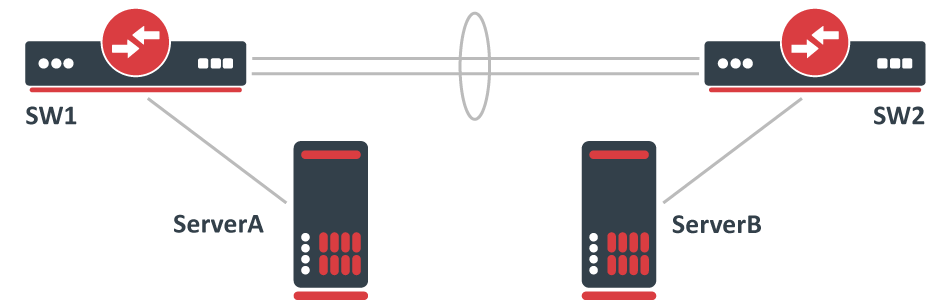

Consider the following scenario: you have created a LAG interface to increase total bandwidth between 2 network nodes; usually, these are switches. For testing purposes to make sure that the LAG interface is working properly, you have attached two servers that transfer data, most commonly the well-known network performance measurement tool Iperf is used to test such setups. For example, you might have made a LAG interface out of two Gigabit Ethernet ports, which gives you a virtual interface that can load balance traffic over both interfaces and theoretically reach 2Gbps throughput, while the servers are connected using a 10Gbps interface, for example, SFP+.
LACP Setup
Configuration
The following configuration is relevant to SW1 and SW2:
/interface/bonding
add mode=802.3ad name=bond1 slaves=ether1,ether2
/interface/bridge
add name=bridge1
/interface/bridge/port
add bridge=bridge1 interface=bond1
add bridge=bridge1 interface=sfp-sfpplus1
Problem
After initial tests, you immediately notice that your network throughput never exceeds the 1Gbps limit even though the CPU load on the servers is low as well as on the network nodes (switches in this case), but the throughput is still limited to only 1Gbps. The reason behind this is that LACP (802.ad) uses transmit hash policy in order to determine if traffic can be balanced over multiple LAG members, in this case, a LAG interface does not create a 2Gbps interface, but rather an interface that can balance traffic over multiple slave interfaces whenever it is possible. For each packet a transmit hash is generated, this determines through which LAG member the packet will be sent, this is needed in order to avoid packets being out of order, there is an option to select the transmit hash policy, usually, there is an option to choose between Layer2 (MAC), Layer3 (IP) and Layer4 (Port), in RouterOS, this can be selected by using the transmit-hash-policy parameter. In this case, the transmit hash is the same since you are sending packets to the same destination MAC address, as well as the same IP address and Iperf uses the same port as well, this generates the same transmit hash for all packets and load balancing between LAG members is not possible. Note that packets will not always get balanced over LAG members even though the destination is different, this is because the standardized transmit hash policy can generate the same transmit hash for different destinations, for example, 192.168.0.1/192.168.0.2 will get balanced, but 192.168.0.2/192.168.0.4 will NOT get balanced in case layer2-and-3 transmit hash policy is used and the destination MAC address is the same.
Symptoms
  • Traffic going through only one LAG member.
Solution
Choose the proper transmit hash policy and test your network's throughput properly. The simplest way to test such setups is to use multiple destinations, for example, instead of sending data to just one server, send data to multiple servers. This will generate a different transmit hash for each packet and will make load balancing across LAG members possible. For some setups, you might want to change the bonding interface mode to increase the total throughput. For UDP traffic balance-rr mode might be sufficient, but can cause issues for TCP traffic. You can read more about selecting the right mode for your setup here.

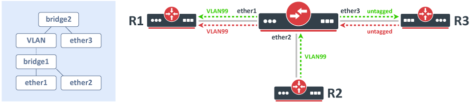

VLAN on a bridge in a bridge
Consider the following scenario: you have a set of interfaces (don't have to be physical interfaces) and you want all of them to be in the same Layer2 segment. The solution is to add them to a single bridge, but you require that traffic from one port tags all traffic into a certain VLAN. This can be done by creating a VLAN interface on top of the bridge interface and by creating a separate bridge that contains this newly created VLAN interface and an interface that is supposed to add a VLAN tag to all received traffic. A network diagram can be found below:
VLAN on Bridge in Bridge
Configuration
/interface/bridge
add name=bridge1
add name=bridge2
/interface/vlan
add interface=bridge1 name=VLAN vlan-id=99
add bridge=bridge1 interface=ether2
add bridge=bridge2 interface=VLAN
add bridge=bridge2 interface=ether3
Problem
To better understand the underlying problems, let's first look at the bridge host table.
[admin@switch] /interface/bridge/host/print where !local
Flags: X - disabled, I - invalid, D - dynamic, L - local, E - external
# MAC-ADDRESS VID ON-INTERFACE BRIDGE
0 D CC:2D:E0:E4:B3:A1 ether1 bridge1
1 D CC:2D:E0:E4:B3:A2 ether2 bridge1
2 D CC:2D:E0:E4:B3:A1 VLAN bridge2
3 D CC:2D:E0:E4:B3:A2 VLAN bridge2
4 D CC:2D:E0:E4:B3:A3 ether3 bridge2
Devices on ether1 and ether2 need to send tagged packets with VLAN-ID 99 in order to reach the host on ether3 (other packets do not get passed towards the VLAN interface and further bridged with ether3). We can see in the host table that bridge2 has learned these hosts. Packets coming from ether3 to ether1 will be correctly sent out tagged and traffic will not be flooded in bridge1. But since MAC learning is only possible between bridge ports and not on interfaces that are created on top of the bridge interface, packets sent from ether2 to ether3 will be flooded in bridge1.
Also if a device behind ether3 is using (R)STP, then ether1 and ether2 will send out tagged BPDUs which violate the IEEE 802.1W standard. Because of the broken MAC learning functionality and broken (R)STP, this setup and configuration must be avoided. It is also known that in some setups this kind of configuration can prevent you from connecting to the device by using MAC telnet.

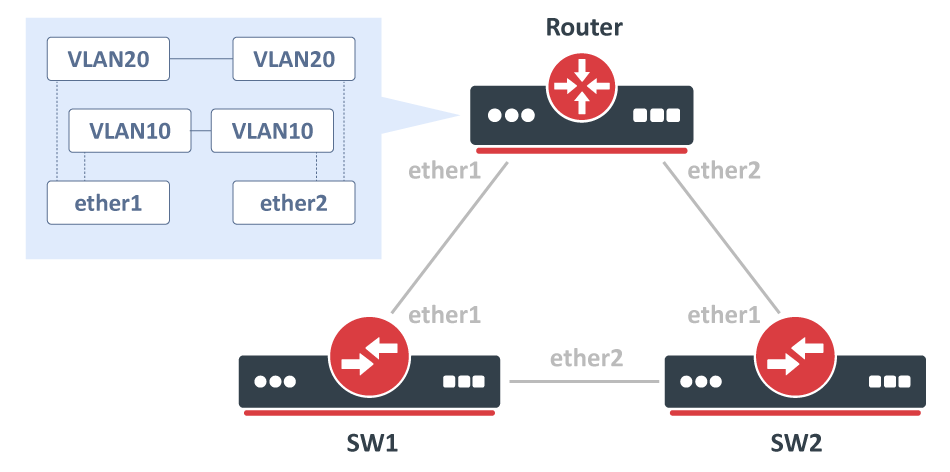

A very similar case to VLAN on a bridge in a bridge: consider the following scenario. You have a couple of switches in your network and you are using VLANs to isolate certain Layer2 domains and connect these switches to a router that assigns addresses and routes the traffic to the world. For redundancy, you connect all switches directly to the router and have enabled RSTP, but to be able to set up DHCP Server you decide that you can create a VLAN interface for each VLAN on each physical interface that is connected to a switch and add these VLAN interfaces in a bridge. A network diagram can be found below:
Bridged VLANs
Configuration
Only the router part is relevant to this case, switch configuration doesn't really matter as long as ports are switched. Router configuration can be found below:
/interface/bridge
add name=bridge10
add name=bridge20
/interface/vlan
add interface=ether1 name=ether1_v10 vlan-id=10
add interface=ether1 name=ether1_v20 vlan-id=20
add interface=ether2 name=ether2_v10 vlan-id=10
add interface=ether2 name=ether2_v20 vlan-id=20
add bridge=bridge10 interface=ether1_v10
add bridge=bridge10 interface=ether2_v10
add bridge=bridge20 interface=ether1_v20
add bridge=bridge20 interface=ether2_v20
Problem
You might notice that the network is having some weird delays or even the network is unresponsive. You might notice that there is a loop detected (packet received with own MAC address) and some traffic is being generated out of nowhere. The problem occurs because a broadcast packet that is coming from either one of the VLAN interfaces created on the Router will be sent out the physical interface, the packet will be forwarded through the physical interface, through a switch and will be received back on a different physical interface, in this case, broadcast packets sent out ether1_v10 will be received on ether2, the packet will be captured by ether2_v10, which is bridged with ether1_v10 and will get forwarded again via the same path (loop). (R)STP might not always detect this loop since (R)STP is not aware of any VLANs. A loop does not exist with untagged traffic, but exists with tagged traffic. In this scenario, it is quite obvious to spot the loop, but in more complex setups it is not always easy to detect the network design flaw. Sometimes this network design flaw might go unnoticed for a very long time if your network does not use broadcast traffic, usually, Neighbor Discovery Protocol is broadcasting packets from the VLAN interface and will usually trigger a loop detection in such a setup. Sometimes it is useful to capture the packet that triggered a loop detection, this can be done by using a sniffer and analyzing the packet capture file:
/tool/sniffer
set filter-mac-address=4C:5E:0C:4D:12:44/FF:FF:FF:FF:FF:FF \
filter-interface=ether1 filter-direction=rx file-name=loop_packet.pcap
Or a more convenient way using logging:
/interface/bridge/filter
add action=log chain=forward src-mac-address=4C:5E:0C:4D:12:44/FF:FF:FF:FF:FF:FF
add action=log chain=input src-mac-address=4C:5E:0C:4D:12:44/FF:FF:FF:FF:FF:FF
Symptoms
  • Port blocked by (R)STP.
  • Loops in the network.
  • Low throughput.
  • Port flapping.
  • Network inaccessible.
Solution
A solution is to use bridge VLAN filtering in order to make all bridges compatible with IEEE 802.1W and IEEE 802.1Q.

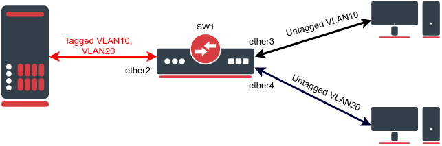

You need to create a network setup where multiple clients are connected to separate access ports and isolated by different VLANs. This traffic should be tagged and sent to the appropriate trunk port. Access ports are configured using a pvid property. As the trunk port is used on both VLANs, you decide to simplify configuration by adding a single bridge VLAN table entry and separating VLANs by a comma. This is especially useful when tagged trunk ports are used across large numbers of VLANs or even certain VLAN ranges (e.g. vlan-id=100-200). See the network diagram and configuration below.
Switch Multiple Untagged
Configuration
/interface/bridge
add name=bridge1 vlan-filtering=yes
add bridge=bridge1 interface=ether3 pvid=10
add bridge=bridge1 interface=ether4 pvid=20
/interface/bridge/vlan
add bridge=bridge1 tagged=ether2 vlan-ids=10,20
Problem
Traffic is correctly forwarded and tagged from access ports to trunk port, but you might notice that some broadcast or multicast packets are actually flooded between both untagged access ports, although they should be on different VLANs. Furthermore, broadcast and multicast traffic from the tagged port is also flooded to both access ports. This might raise some security concerns as traffic from different networks can be sniffed. When you look at the bridge VLAN table, you notice that a single entry has been created for VLANs 10 and 20, and both untagged ports are part of the same VLAN group.
[admin@SW1] /interface/bridge/vlan/print where tagged=ether2
Columns: BRIDGE, VLAN-IDS, CURRENT-TAGGED, CURRENT-UNTAGGED
# BRIDGE VLAN-IDS CURRENT-TAGGED CURRENT-UNTAGGED
;;; port with pvid added to untagged group which might cause problems, consider adding a separate VLAN entry
0 bridge1 10 ether2 ether3
20 ether4
Symptoms
  • Traffic is flooded between different VLANs
  • Red warning: port with pvid added to untagged group which might cause problems, consider adding a separate VLAN entry
Solution
When access ports have been configured using the pvid property, they get dynamically added to the appropriate VLAN entry. After creating a static VLAN entry with multiple VLANs or a VLAN range, the untagged access port with a matching pvid also gets included in the same VLAN group or range. It might be useful to define a large number of VLANs using a single configuration line, but extra caution should be taken when access ports are configured. For this example, separate VLAN entries should be created:
add bridge=bridge1 tagged=ether2 untagged=ether3 vlan-ids=10
add bridge=bridge1 tagged=ether2 untagged=ether4 vlan-ids=20

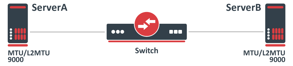

MTU inconsistency
Consider the following scenario: you have multiple devices in your network. Most of them are used as a switch/bridge in your network, and there are certain endpoints that are supposed to receive and process traffic. To decrease the overhead in your network, you have decided to increase the MTU size, so you set a larger MTU size on both endpoints, but you start to notice that some packets are being dropped.
MTU Issues
Configuration
In this case, both endpoints can be any type of device, we will assume that they are both Linux servers that are supposed to transfer a large amount of data. In such a scenario, you would have probably set interface MTU to 9000 on ServerA and ServerB and on your Switch you have probably set something similar to this:
/interface/bridge
add name=bridge1
add interface=ether1 bridge=bridge1
add interface=ether2 bridge=bridge1
Problem
This is a very simple problem, but in larger networks, it can be hard to detect. For instance, ping might be working since a generic ping packet will be 70 bytes long (14 bytes for Ethernet header, 20 bytes for IPv4 header, 8 bytes for ICMP header, 28 bytes for ICMP payload), but data transfer might not work properly. The reason why some packets might not get forwarded is that MikroTik devices running RouterOS by default have the MTU set to 1500 and L2MTU set to something around 1580 bytes (depending on the device), but the Ethernet interface will silently drop anything that does not fit into the L2MTU size. Note that the L2MTU parameter is not relevant to x86 or CHR devices. For a device that is only supposed to forward packets, there is no need to increase the MTU size; it is only required to increase the L2MTU size. RouterOS will not allow you to increase the MTU size larger than the L2MTU size. If you require the packet to be received on the interface and the device needs to process this packet rather than just forwarding it, for example, in the case of routing, then it is required to increase the L2MTU and the MTU size, but you can leave the MTU size on the interface to the default value if you are using only IP traffic (that supports packet fragmentation) and don't mind that packets are being fragmented. You can use the ping utility to make sure that all devices are able to forward jumbo frames:
/ping 192.168.88.1 size=9000 do-not-fragment
Remember that the L2MTU and MTU size needs to be larger than or equal to the ping packet size on the device from which and to which you are sending a ping packet since ping (ICMP) is IP traffic that is sent out from an interface over Layer3.
Symptoms
  • Web pages are not able to load up, but ping works properly.
  • Tunnels dropping traffic.
  • Specific protocols are broken.
  • Large packet loss.
Solution
Increase the L2MTU size on your Switch:
/interface/ethernet
set ether1,ether2 l2mtu=9000
In case your traffic is encapsulated (VLAN, VPN, MPLS, VPLS, or other), then you might need to consider setting an even larger L2MTU size. In this scenario, it is not needed to increase the MTU size for the reason described above.
warning
Full frame MTU is not the same as L2MTU. L2MTU size does not include the Ethernet header (14 bytes) and the CRC checksum (FCS) field. The FCS field is stripped by the Ethernet driver and RouterOS will never show the extra 4 bytes to any packet. For example, if you set MTU and L2MTU to 9000, then the full-frame MTU is 9014 bytes long. This can also be observed when sniffing packets with "/tool/sniffer/quick" command.

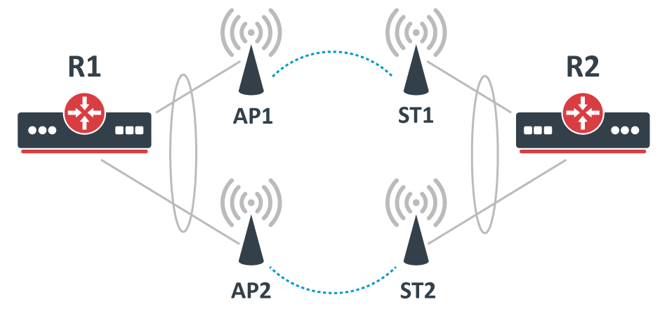

Consider the following scenario: you have set up multiple Wireless links and to achieve maximum throughput and yet to achieve redundancy you have decided to place Ethernet interfaces into a bond and depending on the traffic that is being forwarded you have chosen a certain bonding mode. This scenario can be applied to any case where a bonding interface is created between links that are not directly connected to each other.
LACP over WLAN
Configuration
The following configuration is relevant to R1 and R2:
/interface/bonding
add mode=802.3ad name=bond1 slaves=ether1,ether2 transmit-hash-policy=layer-2-and-3
/ip/address
add address=192.168.1.X/24 interface=bond1
The following configuration is relevant to AP1, AP2, ST1, and ST2, where X corresponds to an IP address for each device.
/interface/bridge
add name=bridge1 protocol-mode=none
add interface=wlan1 bridge=bridge1
/ip/address
add address=192.168.1.X/24 interface=bridge1
Problem
While traffic is being forwarded properly between R1 and R2, load balancing, link failover are working properly as well, but devices between R1 and R2 are not always accessible or some of them are completely inaccessible (in most cases AP2 and ST2 are inaccessible). After examining the problem you might notice that packets do not always get forwarded over the required bonding slave and as a result, are never received by the device you are trying to access. This is a network design and bonding protocol limitation. As soon as a packet needs to be sent out through a bonding interface (in this case you might be trying to send ICMP packets to AP2 or ST2), the bonding interface will create a hash based on the selected bonding mode and transmit-hash-policy and will select an interface, through which to send the packet out, regardless of whether the destination is only reachable through a certain interface. Some devices will be accessible because the generated hash matches the interface, on which the device is located, but it might not choose the needed interface as well, which will result in an inaccessible device. Only broadcast bonding mode does not have this kind of protocol limitation, but this bonding mode has a very limited use case.
Symptoms
  • Limited connectivity
  • Unstable links (in case of balance-rr)
Solution
Bonding interfaces are not supposed to be connected using indirect links, but it is still possible to create a workaround. The idea behind this workaround is to find a way to bypass packets being sent out using the bonding interface. There are multiple ways to force a packet not to be sent out using the bonding interface, but essentially the solution is to create new interfaces on top of physical interfaces and add these newly created interfaces to a bond instead of the physical interfaces. One way to achieve this is to create EoIP tunnels on each physical interface, but that creates a huge overhead and will reduce overall throughput. You should create a VLAN interface on top of each physical interface instead. This creates a much smaller overhead and will not impact overall performance noticeably. Here is an example of how R1 and R2 should be reconfigured:
/interface/vlan
add interface=ether1 name=VLAN_ether1 vlan-id=999
add interface=ether2 name=VLAN_ether2 vlan-id=999
/interface/bonding
add mode=balance-xor name=bond1 slaves=VLAN_ether1,VLAN_ether2 transmit-hash-policy=layer-2-and-3
/ip/address
add address=192.168.11.X/24 interface=ether1
add address=192.168.22.X/24 interface=ether2
AP1 and ST1 only need updated IP addresses to the correct subnet:
/ip/address
add address=192.168.11.X/24 interface=bridge1
The same changes must be applied to AP2 and ST2 (make sure to use the correct subnet):
/ip/address
add address=192.168.22.X/24 interface=bridge1
With this approach, you create the least overhead and the fewest configuration changes are required.
warning
LACP (802.3ad) is not meant to be used in setups, where devices' bonding slaves are not directly connected, in this case, it is not recommended to use LACP if there are Wireless links between both routers. LACP requires both bonding slaves to be at the same link speeds, Wireless links can change their rates at any time, which will decrease overall performance and stability. Other bonding modes should be used instead.
